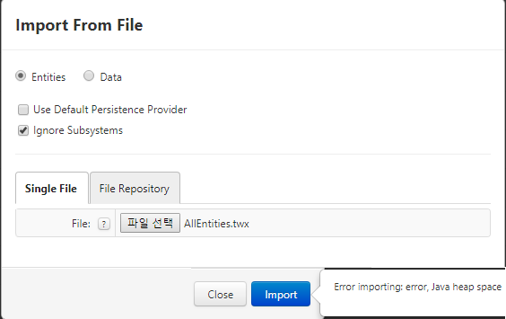

Import Issue "Error importing: error, Java heap space"

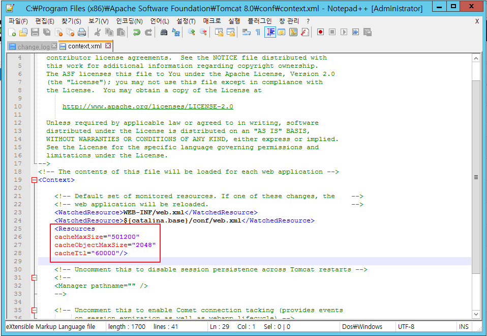

When I try to import, Java heap space appears.
After stopping Tomcat 81 (port used by ThingWorx) I checked that all the related services of the port had disappeared and tried to start Tomcat again.
I added code to the context of Tomcat according to the installation guide.
Also, adding -Xms2048m to the Tomcat manager will not start Tomcat.
How can I get rid of the Java heap space and successfully import?
thank

Jan 22, 2018 11:52 PM UTC
it's cause installed by 32bit
i installed 64bit and import success
