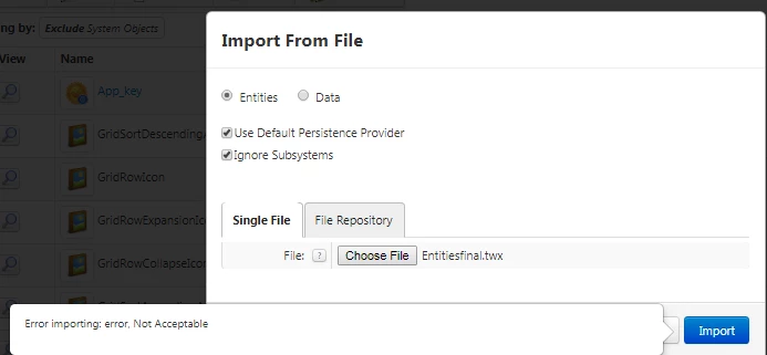

I am using Thingworx 8.0, while importing entities i am getting error as NOT ACCEPTABLE . can anyone fix it?

@pavanpuppala99 Entities imported is from which ThingWorx version and persistence provider ? What exactly these entities contain and is there any dependency of extension which could be missing in imported instance.

Usually the application logs shows a more specific import error message. Go to Monitoring -> Application logs and this may help you understand why the import is failing.
