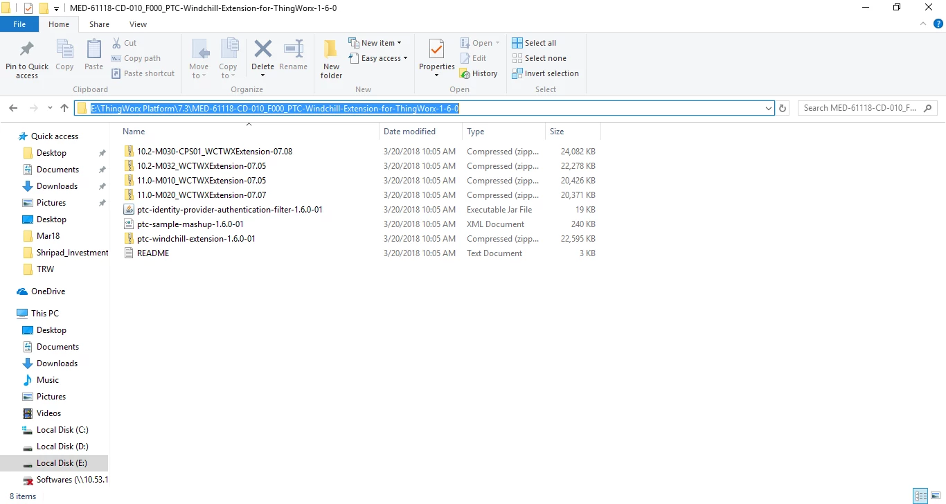

I have checked in zip file it does not contain  metadata.xml .The zip is downloaded from PTC website .
Even more checked other Windchill Extension zips 1-7-0, 1-7-1, 1-8-0 can not find  metadata.xml when zip is extracted.
Installed TW  veersion 7.3 & trying for Navigate configuration . Attached the information from Support Matrix.
Please suggest.

@Shripad Try unzipping ptc-windchill-extension-1.x.x\ptc-windchill-connection-extension . Import the ptc-windchill-connection-extension.zip extension and make sure it get successfully imported..
