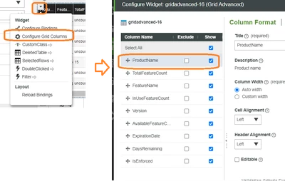

@AP_10343008 column order can be changed.
If you open the Configure Widget popup as below, you can drag a column and change its displaying order.
Can you check column order is changed or not?
