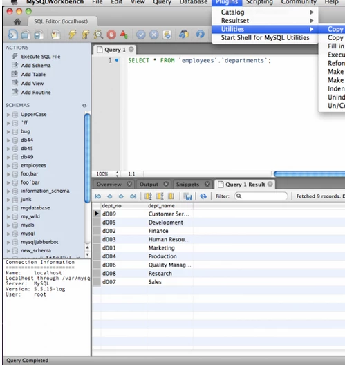

I have created table1 for daily direction in "Mysql workbench 6.3 CE" with 11 Rows , I want to archive all data table in another table archive every day since 2 years to have all history. How can I write such a table?
This the table script:
CREATE TABLE ``table1(
IDINT(11) NOT NULL,
tskVARCHAR(200) NULL DEFAULT NULL,
labelVARCHAR(45) NULL DEFAULT NULL,
statVARCHAR(10) NULL DEFAULT NULL,
noteVARCHAR(200) NULL DEFAULT NULL,
dateVARCHAR(45) NULL DEFAULT NULL,
recVARCHAR(45) NULL DEFAULT NULL,
 PRIMARY KEY (ID),
 UNIQUE INDEXID_UNIQUE(ID` ASC));

Hello.
I gather you are using MySQL for your persistent storage?
Have you tried something like this?
Disclaimer: this comes from a 3rd-party MySQL support area, and not from PTC. Use at your own risk and on a test system before trying it in production.
Suppose you have mydb.mytb and you want to create mydb.mytbcopy
In the mysql client, run the following
USE mydb
CREATE TABLE mytbcopy LIKE mytb;
INSERT INTO mytbcopy SELECT * FROM mytb;
-- Craig A.

Hello Craig ,
Thanks for Reply
I gather you are using MySQL for your persistent storage? Yes , i use MySql Workbench 6.3 CE
in attached pic from the DB where i supposed to write this code ?
December 5, 2018
Hello.
Based on the picture you attached and your earlier post, it looks like your earlier CREATE statement should be used to create the backup (copy-to) table and then the SELECT statement that's in your screen grab would be included inside the INSERT INTO statement.
-- Craig A.
