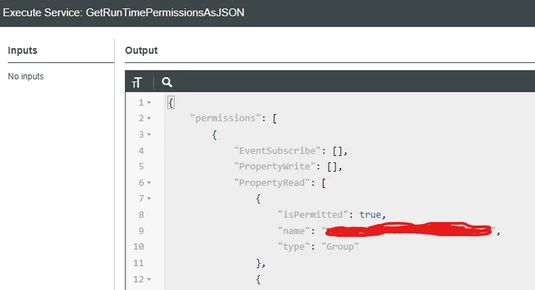

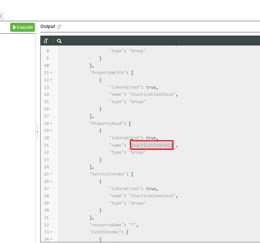

I am trying to get the Permission of a Thing in JS Code, when you services like GetRunTimePermissionsAsJSON  or GetRunTimePermissions I get the InactivationCheck in the output of the Service.
If I Run the Service from the Thing, by opening and executing it, I can see the data properly.

Rocko
Mar 20, 2024 3:51 PM UTC
And you made sure there is no group (accidentally) called "InactivationCheck"?
Please also always include which TWX version you are running. (It did work for me on a 9.3.10)
pshashipreetham
Mar 21, 2024 7:01 AM UTC
Hi @Rocko ,
Thanks for quick response, and apologies I missed Thingworx version, as of now Thingworx Version is 9.2.6.
and yes, there is no user group with "InactivationCheck".
Shashi Preetham || +91 8099838801 || shashi@psptechhub.com
Rocko
Mar 21, 2024 7:29 AM UTC
I don't have a 9.2 around to test, but I've never seen this before. You could try running this with a different user. If it persists, create a ticket with support.
