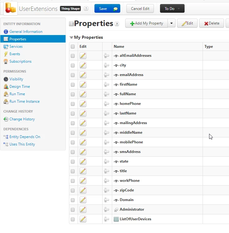

If I add an infotable (list of devices) in user extensions , most of extensions are no more displayed for each users :
UserExtensions definition :

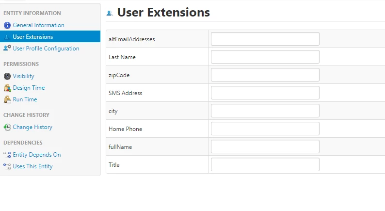

user extensions displayed :
