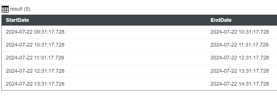

You can use below script to increase startime & endtime by 1 hour
let startTime = new Date();
// End Time plus 1 hour from startTime
let endTime = dateAddHours(startTime, 1);
// CreateInfoTableFromDataShape(infoTableName:STRING("InfoTable"), dataShapeName:STRING):INFOTABLE(TestDS1)
let result = Resources["InfoTableFunctions"].CreateInfoTableFromDataShape({
	infoTableName: "InfoTable",
	dataShapeName: "TestDS1"
// Iterate
let i = 0;
while (i < 5) {
	LOGICS
	result.AddRow({
		"StartDate": startTime,
		"EndDate": endTime
	// StartTime & EndTime will increase at end of iteration
	startTime = endTime;
	i++;
Output :

Jul 22, 2024 5:36 AM UTC
Hi @Hrishabh.Sharma
// Iterate
let i = 0;
while (i < 5) {
	LOGICS
	result.AddRow({
		"EndDate": endTime
	i++;
Output :
