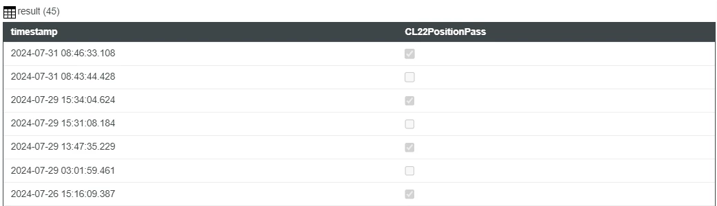

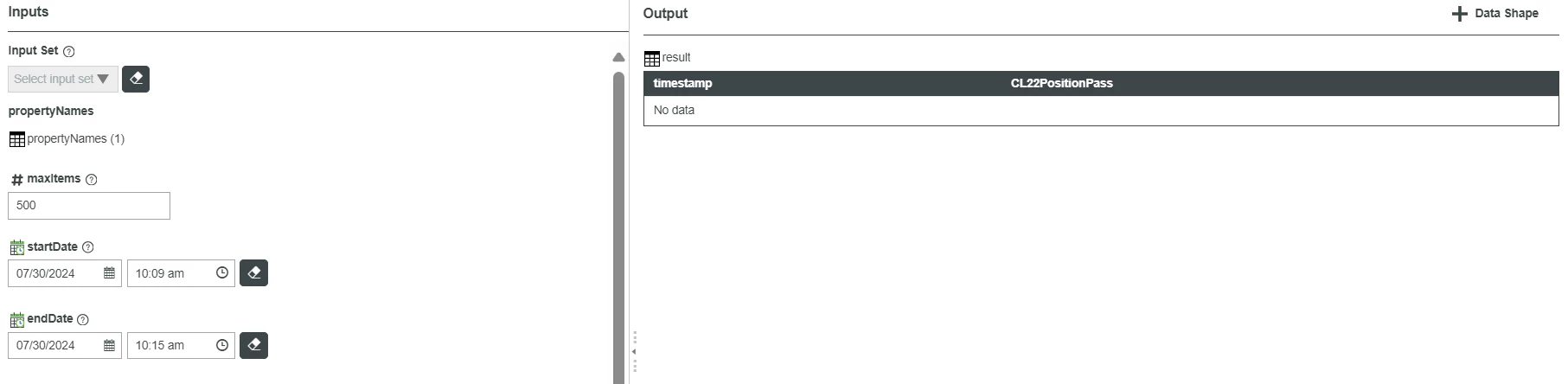

Added note (I think this is the cause of my issue but I don't know how to work around it) I am seeing a data loss issue when querying properties and using a time range. First image I query this property with a time range and get nothing. Second image I use no time range and you can see that there is value history but I can't get it to query it if I use a time range. Any ideas on how to get around this?
Aug 1, 2024 8:29 AM UTC
Hi @JK_10744682
In the screenshots above, the date time range you used for searching does not include any values that are visible in the second screenshot.
Why would you expect values then in the first query execution?
Aug 1, 2024 12:13 PM UTC
You are correct that there aren't any data changes, however the property still had a value during that time range of either true or false and I need to be able to get what the value was during that time range. I think I resolved that part at least by just removing the startDate and getting the most recent value since endDate. I'm just finding that if I query a lot of properties at once and want the values for a specific time range, if there isn't a data change for a property within the time range then no value is returned, rather than returning a row with the actual value at that time which is annoying.
