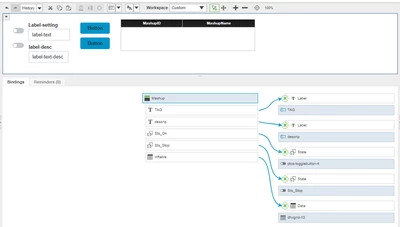

screenshots of both my thing with infotable property and mashup with the collection:

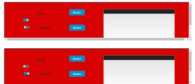

As you can see the grid does not show the inftable values.

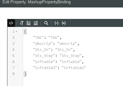

What does you "MashupPropertyBinding" look like?
 "TAG" : "TAG",
 "descrip" : "descript",
 "Sts_on" : "Sts_on",
 "Sts_stop" : "Sts_stop",
 "initTable" : "initTable",
 "initTable2" : "initTable2"

Parameters in my child mashup (All except inftable2 are binded to widgets) :

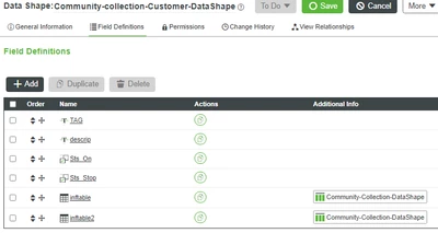

- information being passed to the collection widget is a infotable with datashape describing the parameters above, this property from this thing:
- And my bindings in the collection are these:

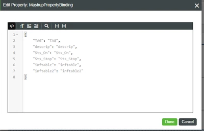

I created a child mashup and parameter bindings:
With the Collection property "MashupPropertyBinding"
In my test case I used the Thing service "GetProperties" to return an Infotable. The Data Shape for the InfoTable is:
I used a different data shape for "inftable". When I bound the infotable to the grid it displayed the columns. Are you seeing the columns in the composer after binding the data source?
