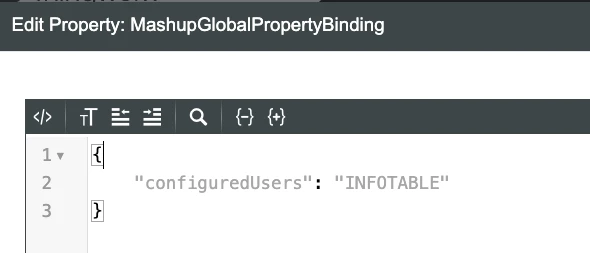

How would one go about specifying a DataShape name for an Infotable property defined in the MashupGlobalPropertyBinding property of a Collection Widget?
It's required to specify a DataShape name for the mashup property in order to be able to bind it to an EventsRouter widget input.

I'm not using a data service for the Infotable I'm trying to bind, it comes from a Collection Widget as a property defined in the MashupGlobalPropertyBinding property of said Collection Widget.
What I would like to know it how to define a datashape name for an infotable in the JSON format required by MashupGlobalPropertyBinding.
