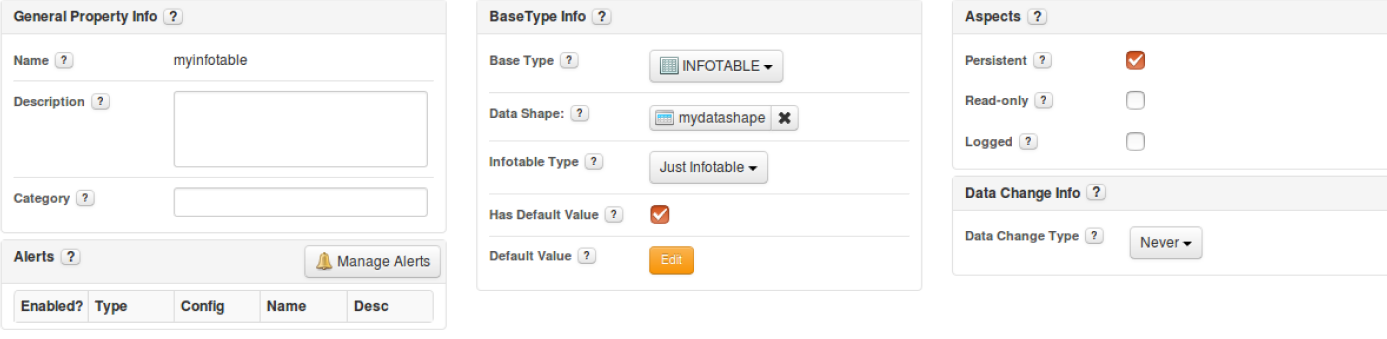

I created a ThingShape and added an InfoTable to it. The DataShape associated with my Infotable is composed of a single string column.
I set a default value to my Infotable and then saved the ThingShape. After that, If I edit my Infotable to check the default value, it is empty.
It seems like the default value was not saved properly. Can anyone help me with this issue ?

Hello, this was reported in Jira TW-4757 and is resolved in ThingWorx versions 7.2.0 and later.
Hope this helps!
