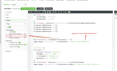

InfoTable.Filter always return null ?
I try to use the function of InfoTable Filter , but it always return null.   What's the correct way to call the function ?
BTW,  infoTable.Find works as expected.

Hi @seanccc.
Can you advise if there is a reason that you need to use the one that doesn't appear to be working vs. the one that does work?  We're taking a look at it but would like to know if you are stalled in your development because of it.

@slangley ,
No it's a blocking problem for me ,  I prefer to try the not working one just because the approach is more concise and straightforward.
