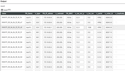

I made a service like thousands of others. But one thing baffles me, output of this service which is Infotable, is also editable. I have never seen this before. As far as I can tell, there is no option in composer, nor in datashape nor in service output which would indicate that this even possible.
What is goin on.
Screenshots explain what I mean. One service's output looks like any other (non editable output), one is almost the same in a nutshell but output is editable.
Anyone?
Editable:

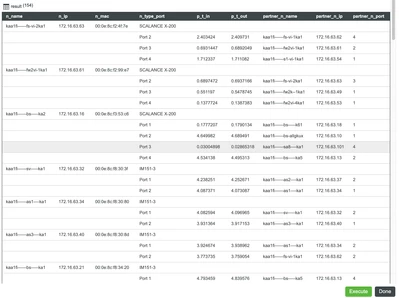

Standard:

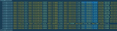

If I open XML files for that datashape entity I can see that there are other parameters (aspects) in FieldDefinition. Mainly
aspect.isReadOnly="false" can cause that this cell could be edited.
I dont understand the logic behind it since if there is no way how you can set those aspects when you designing Datashape entity, why would not be removed.....
here are XMLs:
Manually created Datashape:
Datashape created from Service output:
