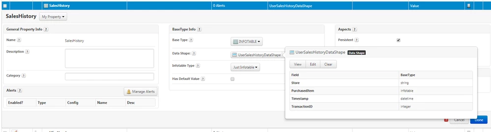

I have added an infotable property (with a defined data shape) to the user extensions thing shape as seen below
.Infotabe propert within User Extension thing shapeInfotabe propert within User Extension thing shape
I cannot update the infotable property on the user. If I open the infotable property up in the user the following is seen:
It seems that the data shape I added to the property is not pulling through.

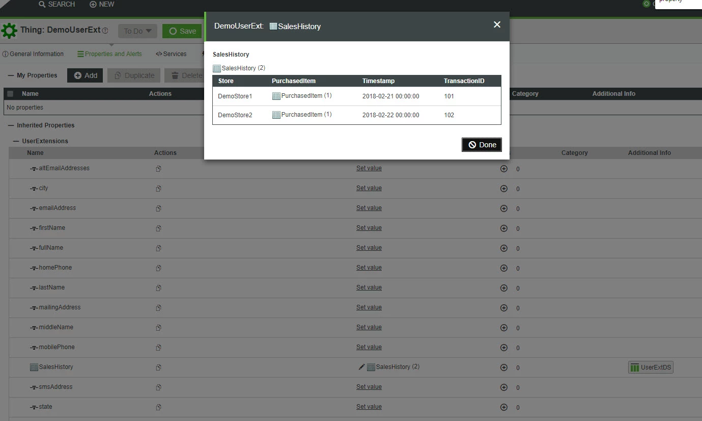

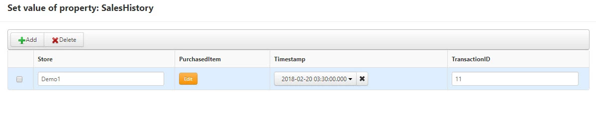

@eengelbrecht Hi, i tested it out on 8.1.0 it's working fine for me.Attaching along couple screenshots for reference.

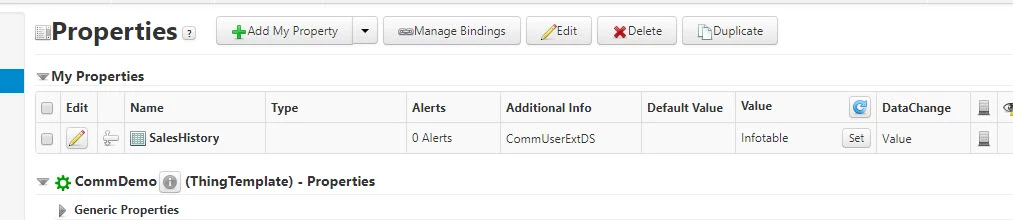

I tested it out also on 8.2.1, works fine. I just added this property to UserExtensions ThingShape > created a Thing with a Generic ThingTemplate and using UserExtensions ThingShape. And just with this I can add the values to the property which is implementing this DS similar to what you have highlighted in your screenshot. Adding my screenshot from New composer from 8.2.1
