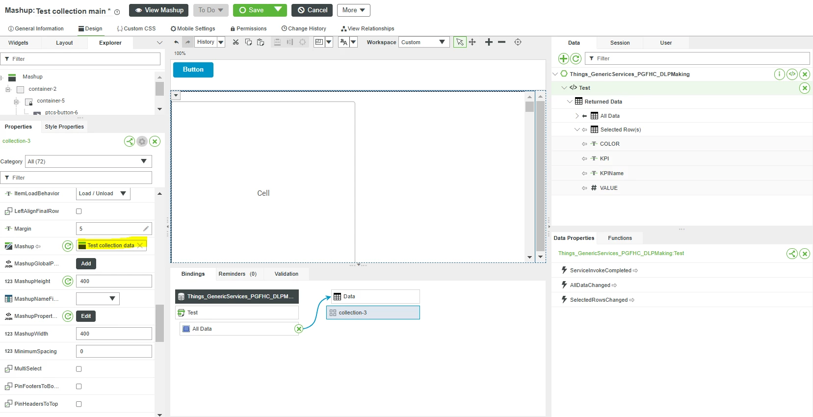

I am using collection widget with data source from a service in the Thing I created.

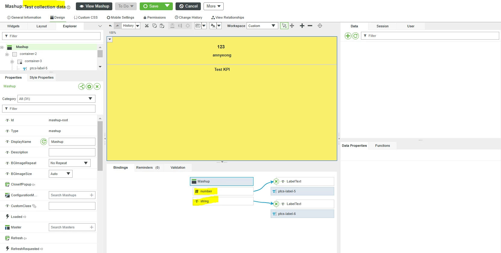

Inside the collection widget, a mashup is already defined but it doesnt seem to load when I view the mashup.
My service doesnt require a parameter and it will give the infotable when executed.

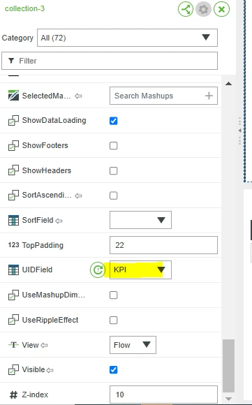

UID Field: KPI

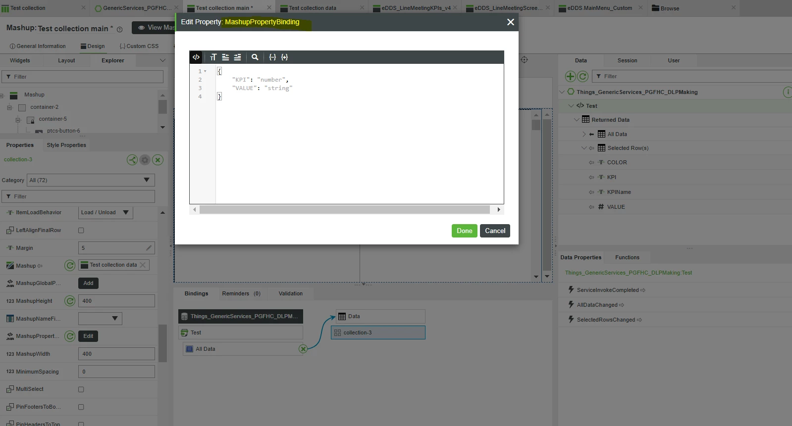

Mashup Property Binding:
"KPI": "number",
"VALUE": "string"

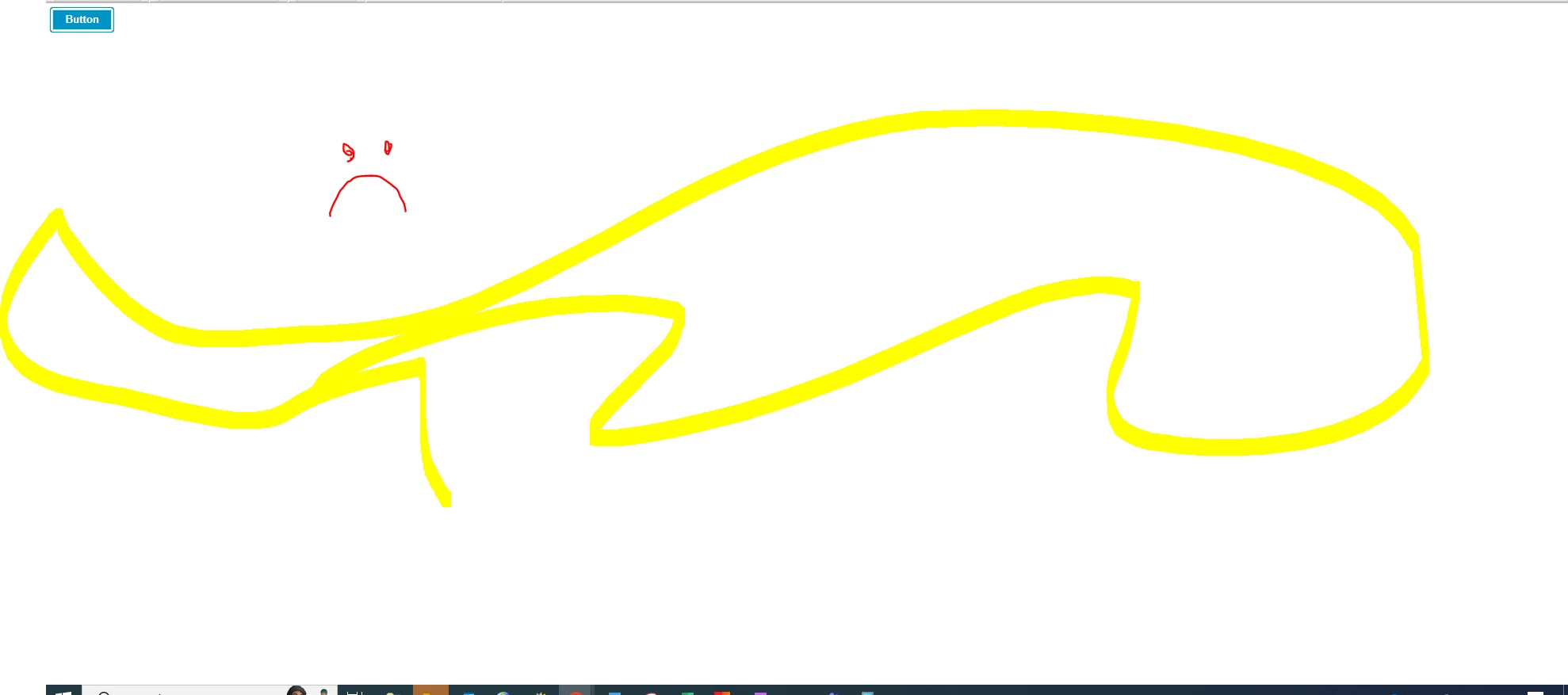

Pls see screenshots, I cannot troubleshoot it, its not giving anything when I load the mashup

Everything seems good but in Mashup property binding you have written "VALUE" instead of "Value" (which matches with infotable) .
Just Correct it.

But even with wrong mapping it should show the 3 collection-mashups. With empty values but the childmashup does seem to have static content which should show up.
Therefore, also make sure that you are executing the "Test" service on MashupLoaded. I assume it is not called?
