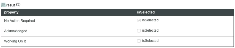

I have a service that returns a list in the following format: returned list with selectionreturned list with selection

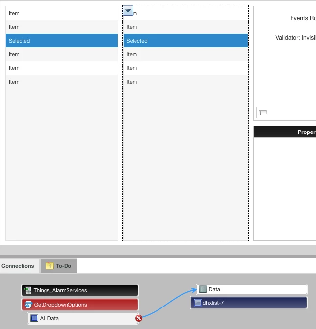

When I use it on a mashup with a list item, the "selected" item is not displayed upon list loading.Screen Shot 2019-03-05 at 18.24.10.png
loaded list, no selectionloaded list, no selection
How can I make it so the list initializes with the selected rows returned by my service?

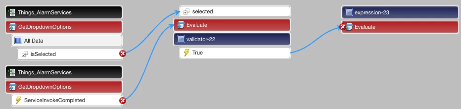

I managed to make my list select a row using my "isSelected" property through the use of a validator and an expression.returned infotablereturned infotable
validator checks it isSelected is truevalidator checks it isSelected is true

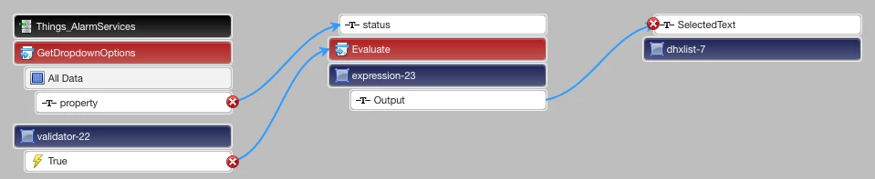

if isSelected is true, expression takes selected propertyif isSelected is true, expression takes selected property

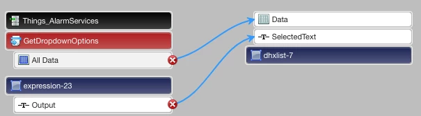

selected property is set as selectedText in listselected property is set as selectedText in list
list with specific selection on loadlist with specific selection on load

Hi, the "isSelected" is just a Boolean property in your Infotable result, it can be renamed to any words so it won't affect how List or this Infotable behaves.
The List has "AutoSelectFirstRow" setting, and also agrees to the SelectedRow(s) selection in the Infotable result from the source service. If the row you want is selected in the service, it will also shown as been selected in the List widget.
