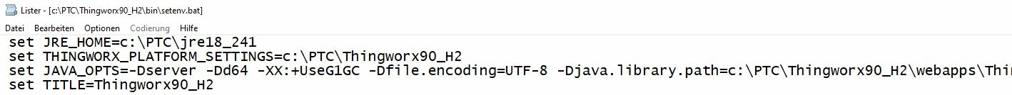

Suppose I am using apache tomcat 9.0.37 zip file  for installing ThingWorx then how I would I be able to set Java Options and Configure tomcat.
Java 11.0.9
tomcat 9.0.37
Thanks in advance.
Dec 21, 2020 8:23 AM UTC
If I understand the question correctly, you can just create setenv.bat in the Tomcat/bin folder
