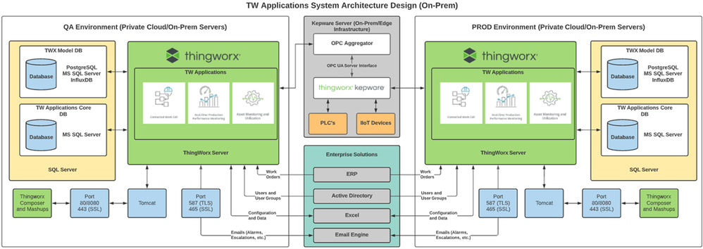

Are there any best practices regarding installing RTPPM w/ MS SQL on an existing ThingWorx running w/ PostgreSQL?

Hello @AndreasGallasch
Pls follow the given help center guide for the same:
https://support.ptc.com/help/thingworx_applications_setup/r1.0/en/#page/applications_setup/SitePrep_LP.html#
 For existing environment, I recommend you to check for the site preparation tab as they may be different for different environments.
Let me know if you have any further query.

There shouldn't be anything necessarily different or special to install RTPPM onto an existing ThingWorx deployment.
Please do make sure your versions match etc. as described in the RTPPM install instructions.

Thank you this helps a lot. Especially this picture explains it:
SitePrep_Sys_Arch_Design
