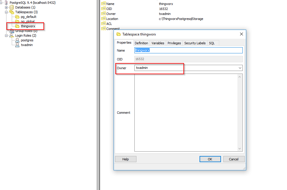

July 18, 2016
Hi again,
after i tried to install on another System i realized that there was some system issue.
I made a clean up with thingworxPostgresDBCleanup.bat i re-runn the thingworxPostgresDBSetup.bat, i need to re-create the thingworks table space manualy, i did the following setup:
- i set the password for twadmin again
- re-set the location of the Storage
- i set the owner of the table space as twadmin
- run the thingworxPostgresSchemaSetup again
and that was it. Everything works now on my system to.
Maybe something hasn't run at the begging with the setup batch but after i made a clean and remade almost everything .
July 18, 2016
Miklos, just so I understand, removing everything and starting from scratch and re-running the script files worked?
