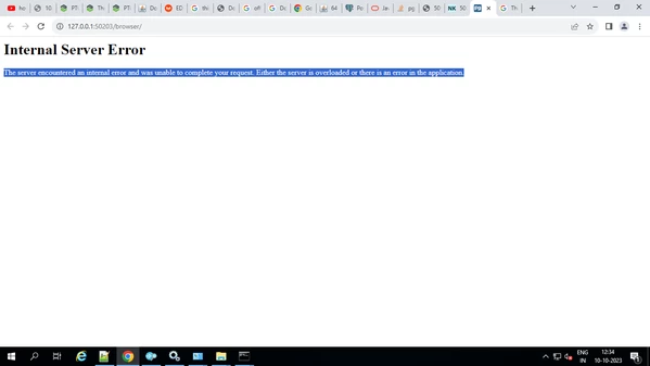

I am getting this error while installing Thingworx at the stage of DB installation.
When following the steps to install thingworx, pgAdmin is giving an error in browser, not able to create DBs and login into the  pgadmin.

Take a look - "ThingWorx: Setting up a PostgreSQL database for external connections": https://www.ptc.com/en/support/article/cs238699

PG Admin is a client tool. Before PGAdmin can connect to the Database, the Postgresql must be running.
Check if your Postgresql is installed successfully and make sure it is running.
If it is running, you can check the configuration as https://www.ptc.com/en/support/article/cs238699.
Is your Postgresql installed on Windows or Linux?

Postgresql is installed, but when i am trying to open it through application or browser it gives below error:
Oct 11, 2023 9:08 AM UTC
What is your expect result of the url http://127.0.0.1:50203/browser?Does it connect to Postgresql Database or Thingworx Server?
