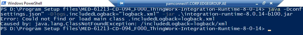

Hi Community,
I'm trying to run integration runtime with logback.xml. When I run below command in CMD
java -DconfigFile="integrationRuntime-settings.json" -Dlogs.includedLogback="logback.xml" -jar .\integration-runtime-8.0.14-b100.jar
Throws an error

Jul 25, 2024 9:58 AM UTC
Any chance you copied that directly from the help center? Can you re-type manually?
It looks like it takes the logback as classname, which indicates the dash/hyphen might be not the "right" one.

Jul 25, 2024 10:34 AM UTC
Hi @Rocko
I didn't copy it. I typed manually only.

Velkumar19-TanzaniteAuthorAnswer
Jul 26, 2024 7:40 AM UTC
Hi @Rocko
Actually, commands work when I run CMD instead of Power Shell. With support of PTC case we found out this.
Resolution :
User Command prompt instead of power shell in windows machine.
