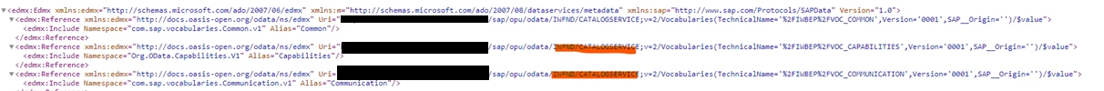

we have some trouble to use the Thingworx SAPOdataconnector with standard SAP interfaces.
Reason for this is clear, the IR (Integration Runtime) tries to parse the Metadata from XML Resource Section (See Screenshot) with https://******/$Values/$Metadata <- But $Metadata does not exist, cause not every "Resource" is an Odata Service itself.
What can be done is for sure just use the content loader functions ... but than the Integration Runtime is useless.
Does anyone knows a workaround -> request for improvement and support ticket is allready opened.
ps: The online viewer is bad ... if you download the Screenshot you can see what is inside
