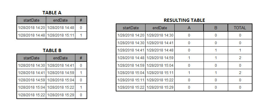

I need to interpolate 2 tables to create a 3rd one based on their values but I cannot figure out how to do it. I tried to use the interpolate service but it did not work as I need.
The scenario is that if an event ends before the starts of another happens it creates a new event. Take a look at the scenario:
I tried first to create the entire resulting table with the correct start and ends and then I would do the logic to Sum the values, but I was not able to get the
Does anyone have an idea of how to do it?

Just iterate over one table, and locate on the other table for matching periods, and at the same time build the resulting table, once done the resulting table, you can build the last column with Derive snippet.

Thanks Carles. This was my inital approach but for some reason I did not get it working, so what I did was to create a table with the union of both and the resulting table based on the start date. It almost got the right results, but the final rows did not get processed. So I added them manually.
Ugly, but it worked. It actually showed me that my screenshot was wrong: from 15:11 to 15:22 I had to have 1 and not zero as a result. I have the impression that if I got the logic right I could simplify this a lot:
