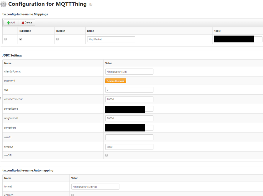

I have build a Thing A defined by Thing Template B
Thing template B is defined using by base Thing Template MQTT and implemented shape that defined some properties TSP.
I defined the property JSON MqttPacket into Thing B and I configurated the broker mqtt into Configuration of Thing B
(see below some information).

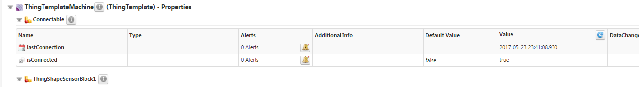

Everything works well for a long time, but sometimes I find the idle service (the value of isConnect is False). In this case , without any change, I save the Thing and the
connection to Mqtt Broker activates. In the following picture the communication on Mqqt Broker is active by the hours 2017-05-23 23:41:08:90 but before it was not active.
Are there a problems on my model or in my configuration ?
Many Thanks
BR
Dimitri

Dimitri, are you seeing any errors/warnings around that time in the application log or anything on the MQTT broker?
May 24, 2017
Hi Sushan,
I found when the communcation to the broker was inactive , last packet received specify the time 23 May 13:51:20.
I tried to find a error  or warning on Thingworx monitoring about that  time, but I'm  found only TRACE or INFO without referenced to Mqtt.

Sushan, please one question :  Is the structure of the model corrected?
May 24, 2017
Hi Dimitri, from the explanation above around the setup it looks okay to me. When you edit and save the thing I believe it'll re-initiate the connection so that would explain why you immediately get new lastConnected time/date. Does this interruption leads to data not being updated in Thing A's property? Could you please share the Property definition for Thing A from the Composer?
