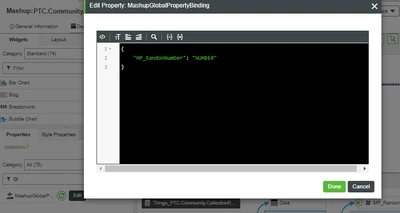

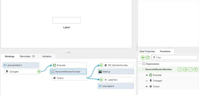

Step 1: Create a Expression with Randon Number Generation in Collection's Child Mashup it should execute on TextBox Values Changed Event and Pass the expression output to 1 Number basetype Mashup Parameter (MP_RandonNumber)
Step 2:  In Collection Widget eidt & update the MashupGlobalPropertyBinding property with created child mashup parameter name which carrying the randon number from child mashup & its basetype.

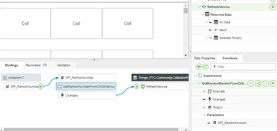

Step 3: Create a auto evaluvate Expression in Parent Mashup to print the data of randon number from collection (ex : Output = MP_RandonNumber).
Step 4: Based on the Expression Changed event you can execute the service from Parent Mashup.
