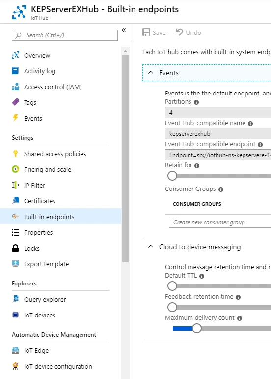

Can you post a screen shot of this part of your Azure account with part of any access keys hidden
event-hub-compatible-name

My IoT Hub name is "KEPServerEXHub", is that a problem? Because I can connect my KEPServerEX IoT Gateway and send data to the Hub without any problem using the hostname "KEPServerEXHub.azure-devices.net".

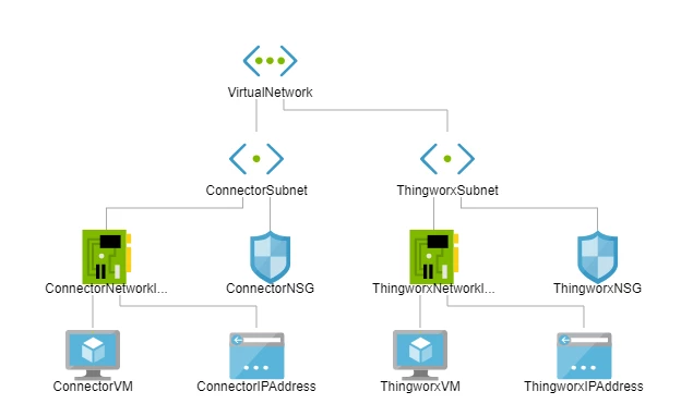

Here is my communication arquitecture:
All is in the Azure Cloude, in the same Region and I can psping and ping my two Virtual Machines without any problem. Using their ip public address and their private address.

The ConnectorVM on the ConnectorSubnet must be able to connect with the ThingWorx IP addresses on the ThingWorxSubnet.
Yes, due to a restriction in Azure blob naming the IoT Hub name must be all lowercase
https://blogs.msdn.microsoft.com/jmstall/2014/06/12/azure-storage-naming-rules/
