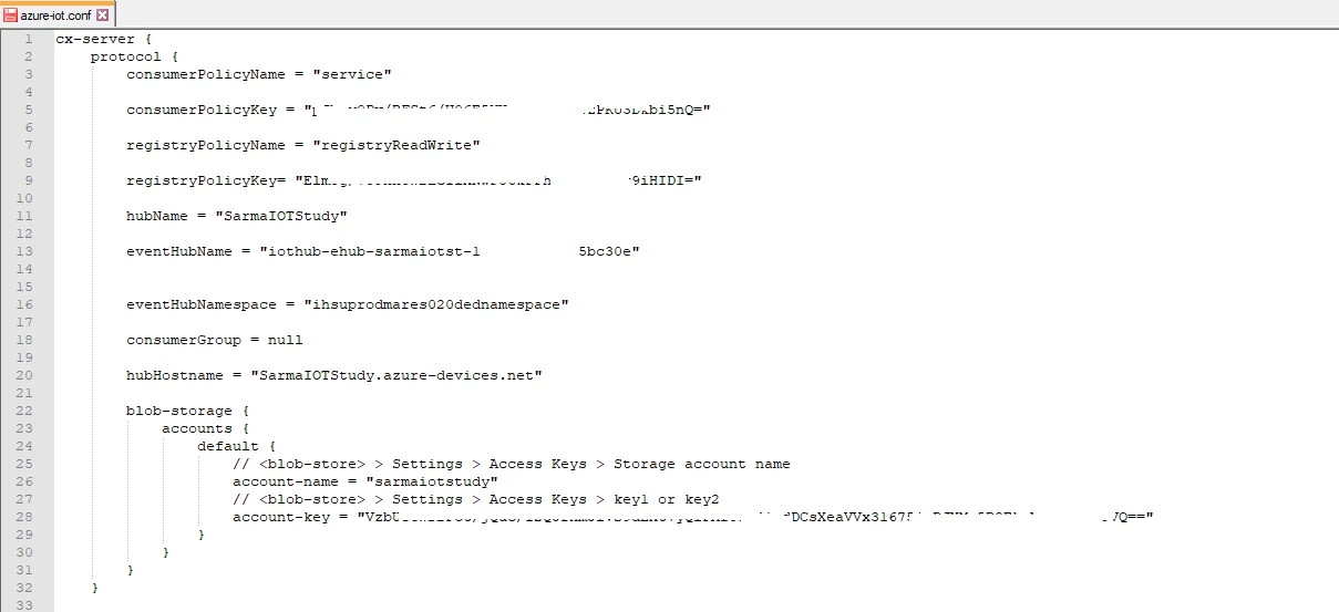

Hi all,
I am trying to do a small IOT study with Azure. But I am getting the following err.
Could you please share your thought on how to overcome this.
Glad if you can share your sample azure-iot.conf.
Please help.
Error Message:
The IoT Hub host SarmaIOTStudy.azure-devices.net is not resolvable. Verify that thecxserver.protocol.hubName configuration matches an IoT hub name in the Azure Console

You must create an IoT hub in Azure with a name that is globally unique, not just unique for your account. The name must be between 3 and 24 characters, lowercase alphanumeric (no underscores)

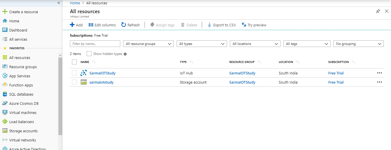

I have set up an IOT HUB in Microsoft Azure already under Free trial.
Please find the attached screenshot of my Azure and Azure-IOT.conf file.
Could you please share the your conf file.

The name you are using for your Azure IoT hub will not work because it has capital letters.
Try creating a new IoT hub that uses all lower case letters and is between 3 and 24 characters long
