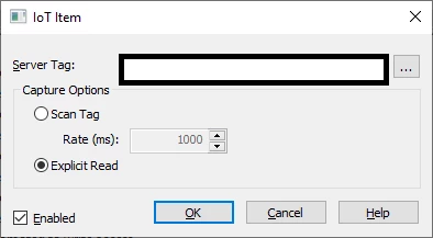

IoTGateway's REST Server: writeResult: "Request rejected."
from the subject, running 6.12 ThingWorks KEPWare Server with IoTGateway REST Server configured as write enabled (for endpoints).
When attempting to write a value to a tag through REST call, the following is returned:
 "writeResults": [
 "id": "<tag_name>",
 "s": false,
 "r": "Request rejected."
It has been observed that the issue clear away once I run an OPCQuick Client and attempt to browse tags. All the tags are hosted locally (trying to write to a simulation driver tag).
Issue reoccurs when re-initializing/restarting the server.
Any ideas?
===Update 1===
The initial configuration was that the tag (IoT Item) "Capture Options" is configured to be "Explicit Read" rather than "Scan Tag". When using the latter, the issue doesn't occur.
The requirement though is to be "Explicit Read"

Jul 2, 2025 2:13 AM UTC
The issue was the tag had a "default" datatype, it had to be specified.
