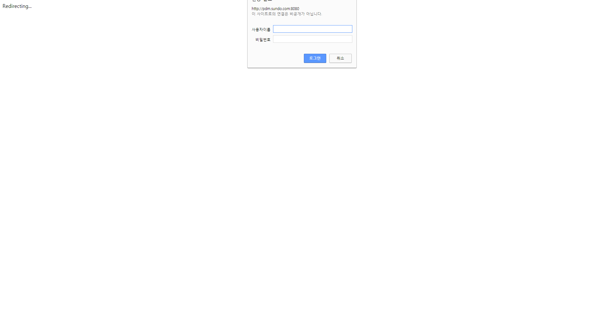

is it possible modify login page?
I have now configured the login page with Appkey.
The user and password are stored in the stream.
I think there might be a problem, so I'm looking for another way.
Can I edit the following pages?
1. FormLogin
2.ThingWorx
I would like to add password search and subscription as shown in the following figure.
I hope that the background behind is also included.
I also hope that URLs to other pages will also be provided as links.

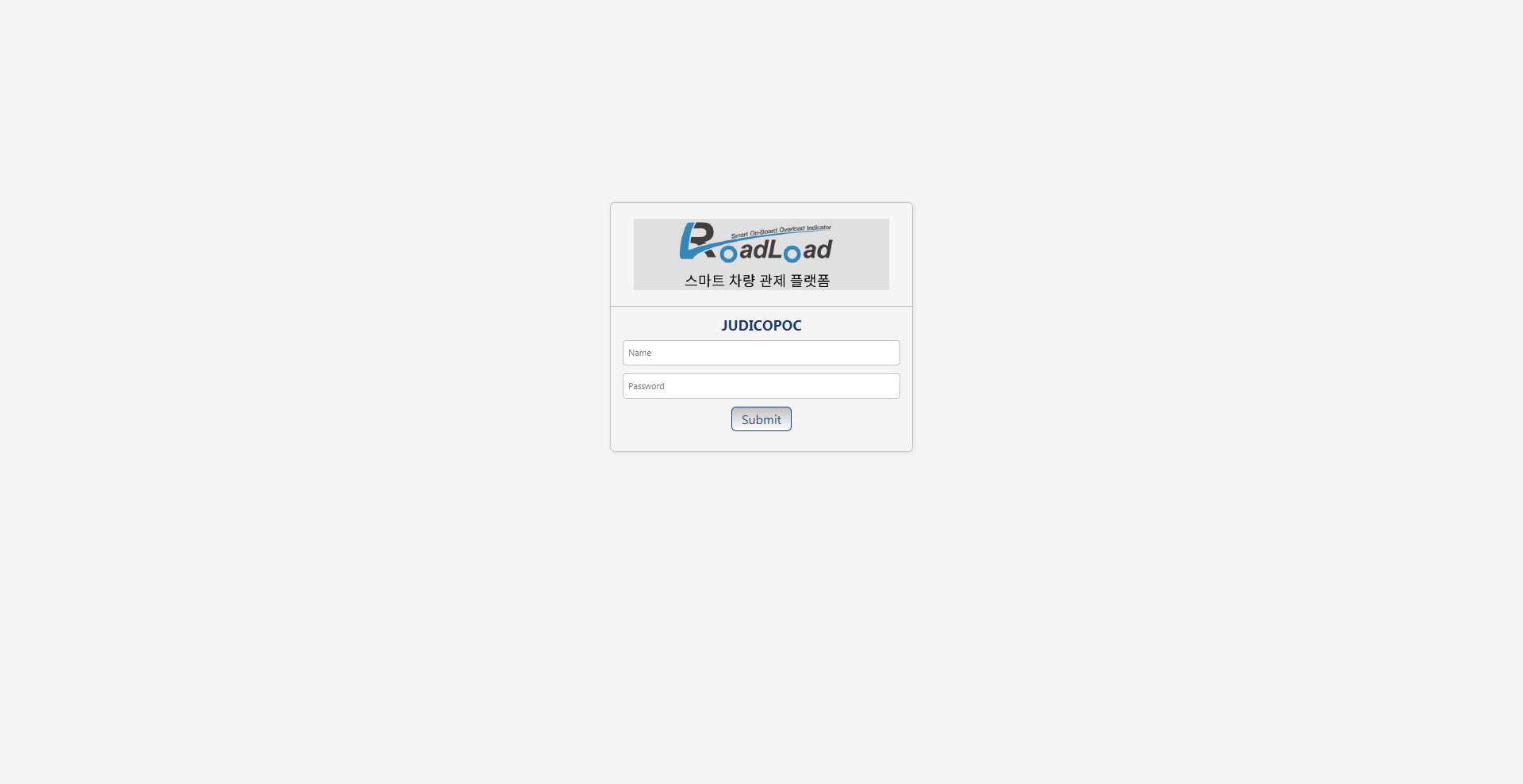

In fact, creating a Form using SSO was very difficult.
I was not able to get the solution according to the advice above.
I made the mashup login form and inserted the mashup into the window of HTML through AppKey.
AppKey's authentication valid session was set to infinite, which looked like a normal login page.
The above procedure worked fine in TWX 7.4, but I did not test it in the upper version.
