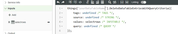

you certainly have a service (A) from which you send the data to the advance grid (link "All Data").
this service has the possibility to link "Selected Row(s)".
this must now be linked to a new service (B) which deletes the rows from the original table.
the service (B) requires the format of the infotable as input
and use perhaps the Service ".DeleteDataTableEntriesWithQueryCriteria()"
the only thing left in mashup is a trigger to do the service (B), by button click or the event form advance grid "DoubleClicked"...
with the service (B) suggested to me, you can then also use multiselect in the advance grid.
January 25, 2022
At the end you must trigger the event of service (B)
as input link in mashup of the service (A) to reload the data for the advance grid. then you see the update.
