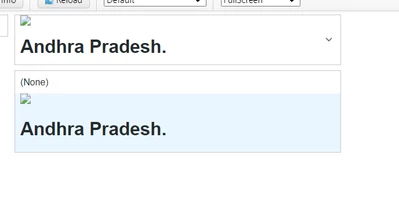

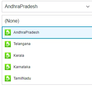

I'm trying to display an image + text in a dropdown. I have tried two methods..
i) under "renderer and state" in the dropdown widget, I'm using a state definition under state-based style definition to add an image. But upon selecting the item we can unable to see the image.
ii)creating an infotable with a html field and using it as the display field in the dropdown widget, in this case the text is coming up but the image isn't.
Please let me know if their is a way to achieve this, thanks!

Your second examples shows a broken image. This means in browser dev tools you will probably see a 404 request. Looks like the link you have is not correct. check the logs.

Rocko19-TanzaniteAnswer
Sep 26, 2024 1:21 PM UTC

Sep 26, 2024 1:46 PM UTC
yes, the issue was with the link. Thanks.
