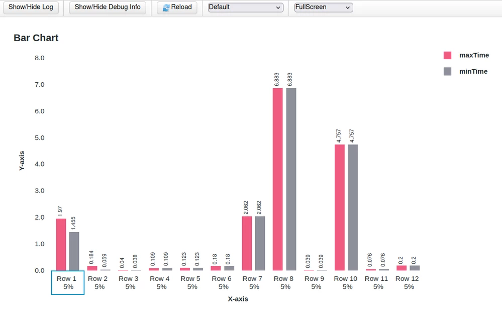

Is it possible to get dual x-axis for column chart (Bar chart/column)
Is it possible to get dual x-axis for column chart. Both x-axis are to be one above other like below image.
I have tried with "\n" character in code but it is taking as space.Anything I am missing out here.Please help me on this.Thanks

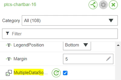

Hi @krishnakomal123 You need to check the field MultipleDataSources property of your Chart Widget and then you will be able to define more than one x-axis fields.
Oct 22, 2024 11:37 AM UTC
After using Multiple datasources, the chart got divided into two charts and showing like below which is not as per chart image I shared above

If you find a way to run this snippet after your mashup loads (e.g. in a custom mini-widget, or via unsafe expressions), it will display the labels with "\n" in them as expected. You can try it in DevTools console.
document.querySelector('ptcs-chart-bar').shadowRoot.querySelector('ptcs-chart-axis').shadowRoot.querySelectorAll('ptcs-label').forEach(label => {
 label.style['max-height'] = null;
 label.shadowRoot.querySelector('#label').style = 'white-space: pre';
But for the love of god, please don't.

Oct 23, 2024 10:49 AM UTC
I tried the same as per the image on Dev tools console. But nothing is changed on UI.Can you please let me know where it is going wrong?

Oct 23, 2024 10:52 AM UTC
Make sure you still return "\n" from your service. If it is the case, then the issue must be related to your mashup structure. Start checking it step by step, i.e. execute this in your DevTools console:
 console.log(label);
Also, those selectors act on the first chart in the mashup only. If you have more than one chart, it may work unexpectedly. Basically, troubleshoot it step by step, comparing it to the DOM you see in DevTools > Inspect.
