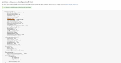

Now about third point which you have mentioned that it is the best way to achieve this task, i would start from it. as you can see screenshot below also for the platform-settings.json so in this fileRepositoryRoot now should i write it as object for eg
"FileRepositoryRoot": {
"claimsRepo": "\\\\aema.universe-world.com\\test\\USER\\...\\claim"
 but it can create an issue if i remove /ThingworxStorage
18-Opal
August 6, 2025
Yeah, that would apply to all repos in the system. If you only want to do this for one of them, you should probably go the symlink route.
