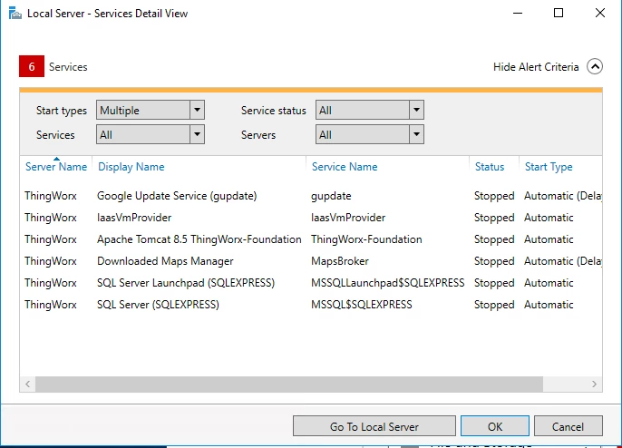

Is that correct that some Thingworx services stopped?
I have Thingworx 8.4 installed on a Windows server machine and it looks works fine. But I noticed some services stopped. I have attached the screen shot with these services. Can anyone help explain if this is acceptable?

It depends how you installed Thingworx.
Usually , if Tomcat and DB is stopped, Thingworx would not work.
Try to refresh services, are these really corresponding to your Platform?
Please check/attach Application.log to look for potential errors.

Thanks for response. Yes that's what I am using. I installed Thingworx foundation at first. Then I installed Thingworx for Manufacturing Application.
