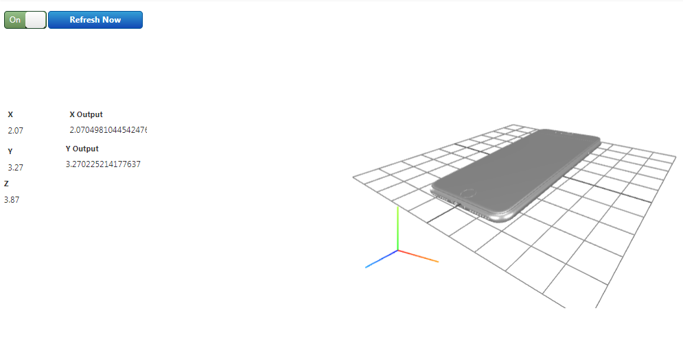

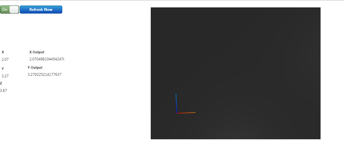

I get the model imported and show on the mashup, but the default view position is looking at the bottom of my 3D model and it is very close to the model too, so i can hardly see anything..it will take my like 7 -10 scrolls to see the whole model.
Is that possible to change the default view position, so it will look nicer like the picture on the right when the mashup just loaded?

I did try change the rotation, but because the view is too close to the model, it doesn't help much, I would still need to zoom out to see the whole view.
