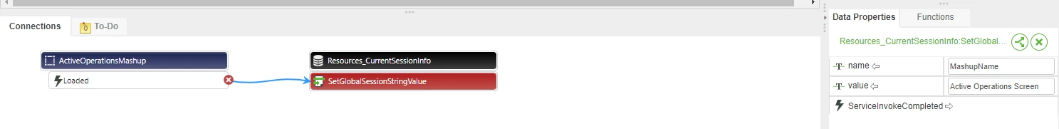

  • whenever a mashup is loaded: call SetGlobalSessionStringValue({ name: "MashupName", value: "Mashup 1 Header" }) where "Mashup 1 Header" is different for each contained mashup. (see ContainedMashupLogic.png attached)

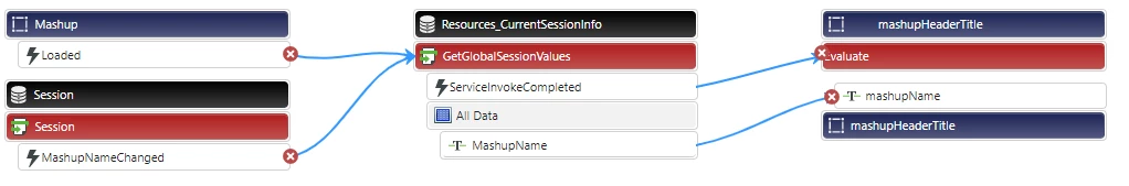

  • on my mashup master, I am calling GetGlobalSessionValues when the mashup is loaded, and when MashupNameChanged event occurs (see MashupMasterLogic.png attached)
  • I am then running an expression to combine MashupName with some other static text, and bound the result of this expression to the label in the Header
What is happening:
  • the header never changes after initial load of the mashup, navigating between the contained mashups does not trigger the change in the header
