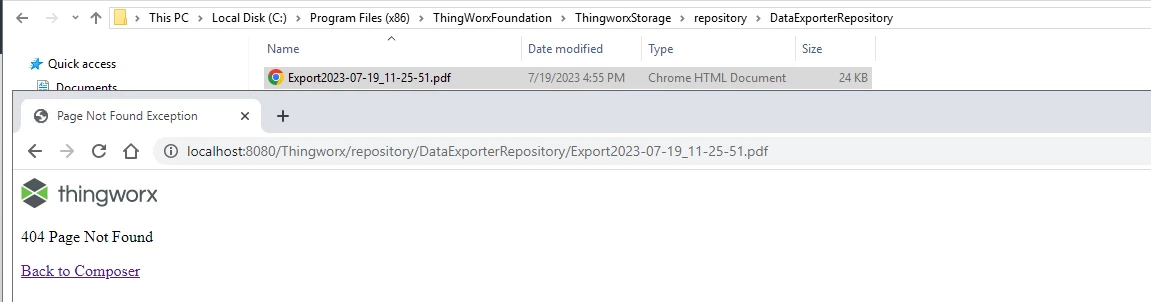

Is there a way to download a file from "ThingWorxFoundation\ThingworxStorage\repository" location?
I have a ThingWorx snippet -Resources["InfotableExporterFunctions"].ExportInfotableAsPdf(params); which is creating a pdf file in the "ThingWorxFoundation\ThingworxStorage\repository" location, but I need that file to be created in my local machine not in the ThingWorx repository.
1. Is there a way to create a file in my local machine ?
2. Or does ThingWorx has a feature to download the created file to my local machine?
Please suggest with your sample code. Thank you

Jul 19, 2023 2:01 PM UTC
Place your file into a FileRepository Thing and it will support downloadable links

Jul 20, 2023 2:22 PM UTC
You can download the generated file via a link like this: http://localhost:8080/Thingworx/FileRepositories/SystemRepository/myfile.pdf
Jul 21, 2023 4:56 AM UTC
Please see the screenshot, unable to download via link.
18-Opal
Jul 21, 2023 5:08 AM UTC
You made a typo — it should be “FileRepositories” instead of “repository”.
