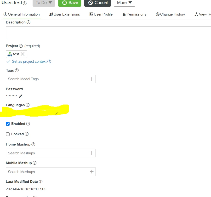

Jan 23, 2024 4:48 PM UTC
Hi @Frowne
Kindly find the attached screenshot, change the language for a particular user at the user journal information tab, and let me know if you have any doubts.
