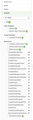

Yes, plenty of those in the snippets section. They are services available in the Entity Services resource
