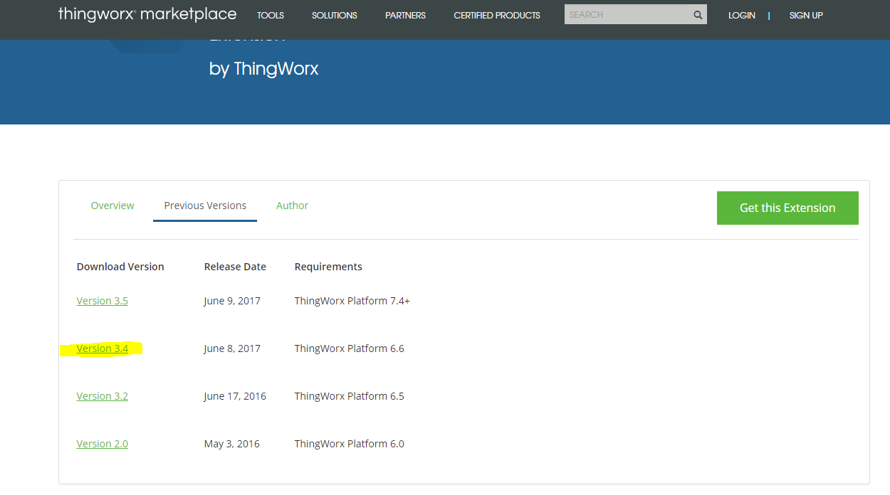

Is there any mail extension present for Thingworx 7.0 or older version?
Currently working on thingworx 7.0 and need to add mail extension for the same.

Hi Sharayu, have you already checked the ThingWorx Marketplace? There's Mail Extension available for download for ThingWorx.

To add to Sushant's reply, please note that for 7.0 you'd be intersted in the "Previous versions" tab, particularly version 3.4 of the mail extension. Mail extension 3.5 is only supported in 7.4+
Jun 26, 2018 9:07 AM UTC
I can't find previous versions in new PTC Marketplace. Where can I get Mail Extension version 3.2 for Thingworx 6.5?
