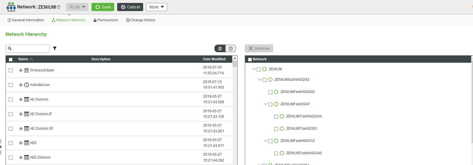

I'm using Thingworx 8.4, I have created a network structure now I would like to re-arrange network elements through a Mashup.
is there any service/snippet available to change parent of network element in the Network Hierarchy?
Is it possible to utilize Thingworx available feature(Attaching Screenshot)?
(The network entity has a mashup( Network Hierarchy) where we can drag and drop network elements in the structure/Hierarchy, is there any possibility to duplicate or reuse this functionality in my mashup).

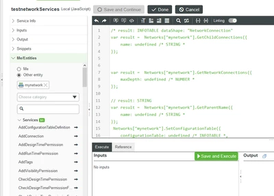

I do not think is possible to modify a network structure after it was created from code, but you can check the available services for Network Entity (Snippets > Other Entity > <NetworkName>  ), maybe some of them will help you:
