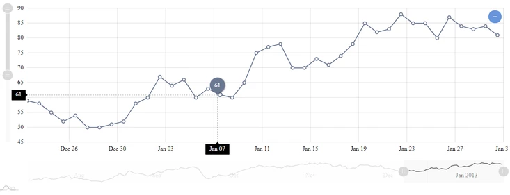

Best answer by Vatsal
@Constantine ,
Thanks for your reply. Giving the values in px was an effective way to define the size of the chart. In addition to that the size was suppose to be defined in the  runtime.css file.
For community,
I have included the zip file of a sample widget for future reference.

Vatsal1-VisitorAuthor
September 12, 2019
Thanks a lot for your reply @slangley .
I tried creating a chart widget using the amChart libraries and was able to do so.
However the rendering is not doe properly in Thingworx. I have attached the screenshots of the rendered images when the chart is made in HTML(amChartHTML.png)
and when it is made in Thingworx(amChartTW.png).
I have also uploaded the runtime.js file i am using in the TW widget. In case you can identify if i am missing anything kindly let me know.
18-Opal
September 12, 2019
Just few observations:
  1. It looks like the chart is squeezed into a container which is too small. This is something you can confirm by checking DOM hierarchy in Chrome Dev Tools;
  2. The chartContainer (together with the corresponding div) seems to be unnecessary;
  3. What if you try to set width on the div you render?
/ Constantine
