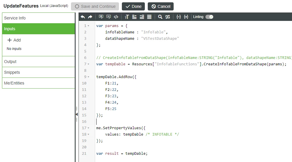

Here I have a Thing with 5 attributes(F1/F2/F3/F4/F5) with Value Stream configured.
Now I uses service of SetPropertyValues to update all attributes in the same moment.
- 1st time set to 11/12/13/14/15,
- 2nd time set to 21/22/23/24/25.

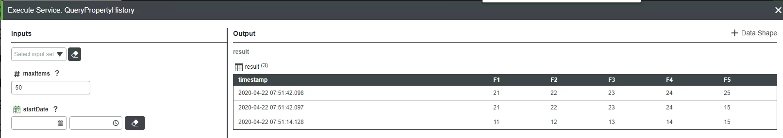

So there should be 2 rows in Value Stream.
But I found 3 rows instead, the 2nd update has been recorded into Value Stream in 2 different ms.

This behavior is normal.
Try to use UpdatePropertyValues() instead and specify the same "time" for all the VTQ values in the InfoTable.

Thank you! Can you paste an example in JavaScript so I can try it in Thingworx Service?
April 23, 2020
Sorry I don't have the JS service handy.
You can maybe re-use the snippet from this post : https://community.ptc.com/t5/ThingWorx-Developers/UpdatePropertyValues-service/m-p/523874/highlight/true#M18471
To get the current date in JS :
var now = new Date();
