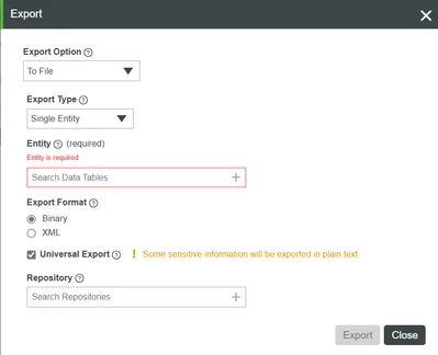

Have you tried Universal Export, with Binary or XML, for entities not data?

how can i export a datatable with binary or XML any idea? Its a datatable actually and i can only import it as data.
Aug 23, 2024 10:52 AM UTC
I mean while exporting data table entity select universal export, and Export data as usual.
Also make sure whatever hashing key (mechanism I am guessing) you are using that is already present on target server.
