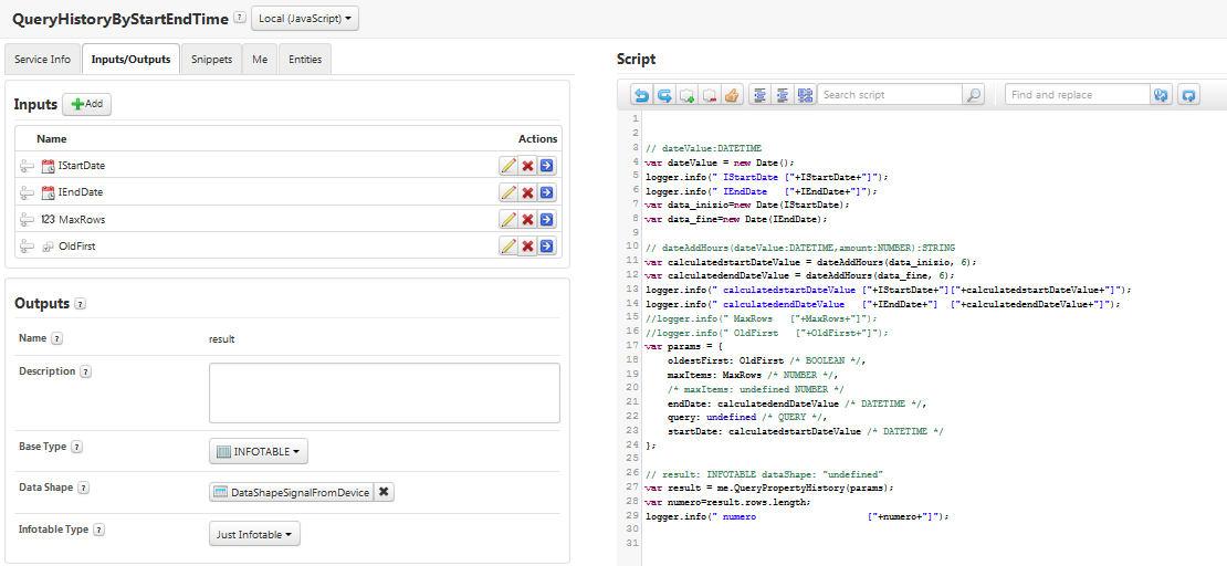

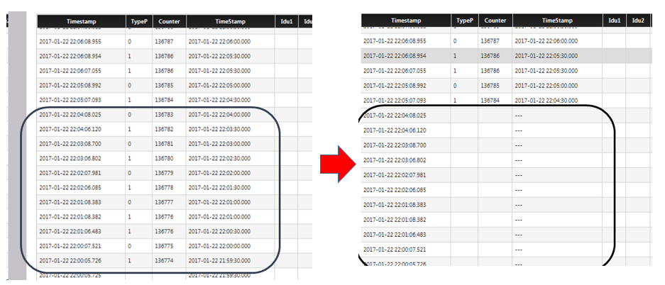

When I use QueryPropertyHistory and increase the time period (change the End Time) some fields returned are empty, but before these values were present

I used  the standard service like QueryPropertyHustory, in the following picture the service used

Dimitri, I have seen this behaviour but the strange part is that for me the entries became available again after few refreshes. Could you check the HomeMashup of this ValueStream or if you Test this service directly in the ValueStream thing to see if the data is still there?
January 24, 2017
When do you update your properties? In Neo4J, there is very likely the chance that if you are updating your properties while you are trying to load the mashup, this would be the result. You would diagnose this by seeing if there are deadlocks in the thread dumps (try using jstack).
