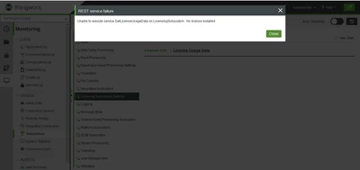

Best answer by raluca_edu
Issue was solved by adding Local System account access rights to Thingworx Platform folder and also after deleting 'trusted storage' (this is done only with PTC support help, not by customers on their own).

3) Monitoring > Subsystem > LicenseSubsystemSettings, It shows popup with the message License is not installed.

mnaeem1-VisitorAuthor
October 7, 2019
Hi @slangley ,
Here is the screen shot of Monitoring > subsystems > Licensing Subsystem Setting
Best Regards,
Naeem
