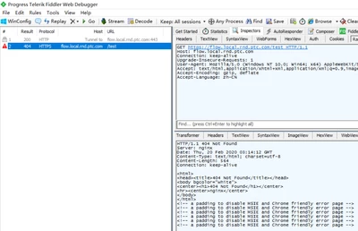

When I execute the command 'flow test oauth <oauth-name>' ,an error occurred:
command text:
flow test oauth Gmail-GmailOAuth -f C:\twxconnector\test\testOauthData.json -t "Test Gmail Oauth"
nginx log:
fiddler:

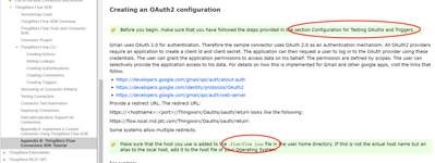

Thank you Raluca Edu,but the help document says that it can be tested before deployment.
And it still doesn't work after I deploy it. ---- same error message

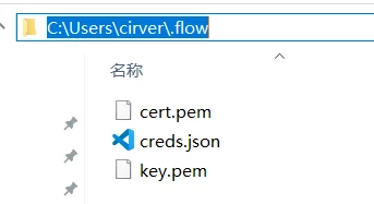

In addition,I can't find the section "Configuration for Testing OAuths and Triggers" and the file with the path '.flow\\flow.json'
my home directory:

Can we have a look at your flow.json file
