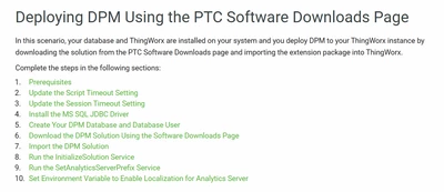

Issue while configuring Digital Performance Management
InitializeSolution service (PTC.Base.Manager Thing) gives more than 100 script log error, and those are not being traced while debugging.
for example, it says database credentials are incorrect however while checking persistent provider is say connected.
Followed below guideline for DPM 9.7.0

I tried again today (Step 8: Run the InitializeSolution Service), and it went well without any changes at my end.
So, I am not sure how but may be due to network issue or timeout the problem caused, as there was not any table created in past but this time all the required table got created in database and service returned all module as configured.

Hello @Surya_Tiwari
Thank you for replying, I am following similar guidelines.
As mentioned above, facing issue in step Run the InitializeSolution Service. Service executes with error, as if return infotable, which tells module configured or got error, when checked the logs, there are more than 100 errors.one example is mentioned above.
I am new to DPM, have installed it on local system. Also. the documentation does not mention about configuring Assets and Kepware.
