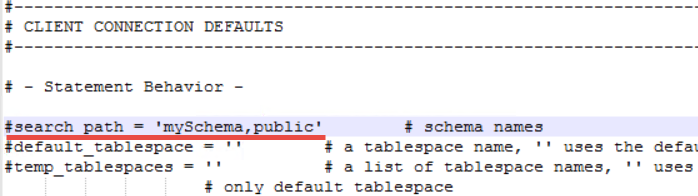

I installed Thingworx 6.5 as per the installation document. However, when I start Tomcat after deploying the war file, I get the following error
"com.thingworx.common.exceptions.ModelAccessException: ERROR: relation "root_entity_collection" does not exist   Position: 24"
I saw some posts related to the same and I corrected the postgresql.conf file as well

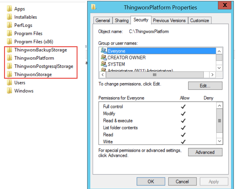

I also ensured that the thingworx folders are in the root folder (C Drive) with all access.

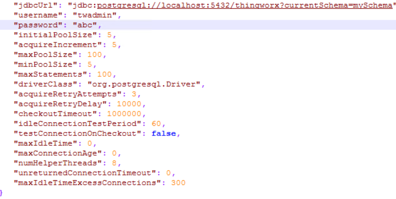

I also ensured that the modelproviderconfig.json is configured properly  (the password is the same in the database as well in the json file)

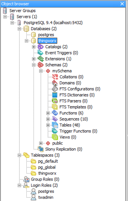

Sriram, can you try running the schema scripts again? Do you have a thingworx database and tablespace?
June 9, 2016
I'll try running the schema. Yes, I verified that the Database and the tables are created.
June 9, 2016
Can you try deploying a different version of ThingWorx? Is this the base 6.5 version or is it a specific patch? (6.5.1, 6.5.2 etc)
